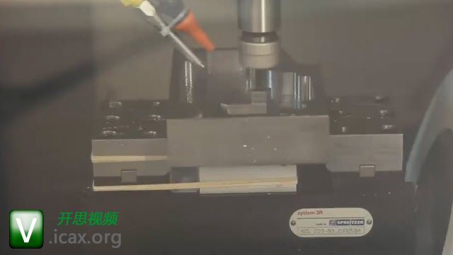

[iMachining视频] iMachining Mikron 钢件加工2
加工参数:
12,700 RPM
187 IPM
.045 Step over
.0023" Chip Thickness
1/4" 5 Flute carbide tool
.625" Deep
1018 Steel
